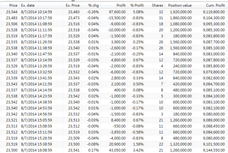

 樓主| 發表於 14-7-19 00:06 | 顯示全部樓層
不, 我是想把全部current total equity(money)用以買/賣 futures contract. 所以我set position size =-100, 但為什麼backtest後不是這樣, number of shares 很奇怪
例如附件, cum profit 有900多萬的, 但為什麼shares 那麼少?

發表於 14-7-19 01:18 | 顯示全部樓層
orangelam 發表於 14-7-19 00:06
不, 我是想把全部current total equity(money)用以買/賣 futures contract. 所以我set position size =-100 ...
Short: 32 Contracts * (23483-23544) * 50 = 97600

 樓主| 發表於 14-7-19 01:48 | 顯示全部樓層
joshsmi 發表於 14-7-19 01:18
above is correct but in row 5, initial equity+acc profit=1000000+9085300(in row 4)=10085300
so, number of futures contracts should be 10085300/60000=168, why not 168 contracts? but in row 5, it only 3 contracts... this is weird. any ideas?
