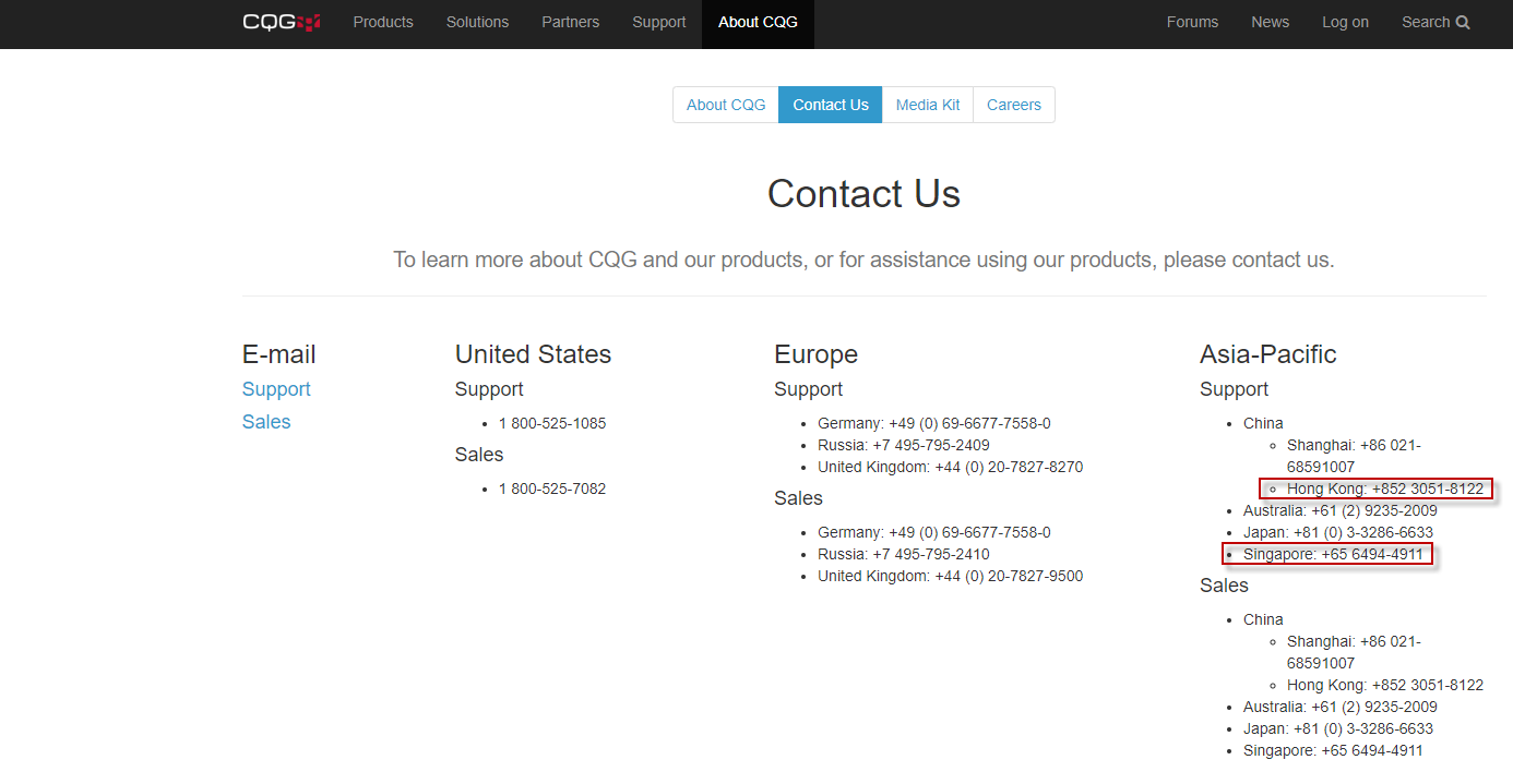

CQG客服聯絡方式
https://www.cqg.com/about-cqg/contact-us
打電話進去香港或新加坡時,可先問Could you speak Mandarin or Chinese?
如果不行的話,再加一句Could you put me through to your coleague who can speak Mandarin or Chinese?
