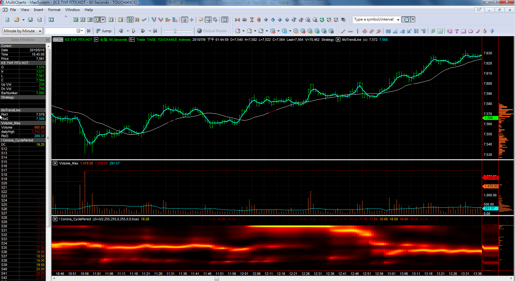

MC模擬畫背景多空趨勢

發表於 13-2-28 22:59 | 顯示全部樓層
最下面那個是什麼=口=!?
還是只是上了馬賽克

程式碼
{ Corona Chart Cycle Period
written by John F. Ehlers copyright (c) 2008
The spectral content of the data are measured in a bank of contiguous
filters as described in "Measuring Cycle Periods" in the March 2008 issue
of Stocks & Commodities Magazine. The filter having the strongest output
is selected as the current dominant cycle period. The cycle period is
measured as the number of bars contained in one full cycle period.
Inputs:
Price((H+L)/2),
LineR(255),
LineG(255),
LineB(0),
FuzzR(255),
FuzzG(0),
FuzzB(0),
ShowDC(True);
Vars:
delta(0.1),
gamma(0),
alpha(0),
beta(0),
N(0),
Period(0),
MaxAmpl(0),
Num(0),
Denom(0),
DC(0),
DomCyc(0),
Color1(0),
Color2(0),
Color3(0),
alpha1(0),
HP(0),
SmoothHP(0);
Arrays:
myI[60](0),
OldI[60](0),
OlderI[60](0),
Q[60](0),
OldQ[60](0),
OlderQ[60](0),
Real[60](0),
OldReal[60](0),
OlderReal[60](0),
Imag[60](0),
OldImag[60](0),
OlderImag[60](0),
Ampl[60](0),
OldAmpl[60](0),
DB[60](0),
OldDB[60](0);
alpha1 = (1 - Sine (360 / 30)) / Cosine(360 / 30);
HP = .5*(1 + alpha1)*(Price - Price[1]) + alpha1*HP[1];
SmoothHP = (HP + 2*HP[1] + 3*HP[2] + 3*HP[3] + 2*HP[4] + HP[5]) / 12;
IF CurrentBar < 7 Then SmoothHP = Price - Price[1];
IF CurrentBar = 1 THEN SmoothHP = 0;
delta = -.015*CurrentBar + .5;
If delta < .1 then delta = .1;
If CurrentBar > 12 Then Begin
For N = 12 to 60 Begin
beta = Cosine(720 / N);
gamma = 1 / Cosine(1440*delta / N);
alpha = gamma - SquareRoot(gamma*gamma - 1);
Q[N] = (.5*N / 6.28318)*(SmoothHP - SmoothHP[1]);
myI[N] = SmoothHP;
Real[N] = .5*(1 - alpha)*(myI[N] - OlderI[N]) + beta*(1 + alpha)*OldReal[N] - alpha*OlderReal[N];
Imag[N] = .5*(1 - alpha)*(Q[N] - OlderQ[N]) + beta*(1 + alpha)*OldImag[N] - alpha*OlderImag[N];
Ampl[N] = (Real[N]*Real[N] + Imag[N]*Imag[N]);
End;
End;
OlderI[N] = OldI[N];
OldI[N] = myI[N];
OlderQ[N] = OldQ[N];
OldQ[N] = Q[N];
OlderReal[N] = OldReal[N];
OldReal[N] = Real[N];
OlderImag[N] = OldImag[N];
OldImag[N] = Imag[N];
OldAmpl[N] = Ampl[N];
OldDB[N] = DB[N];
End;
MaxAmpl = Ampl[12];
If Ampl[N] > MaxAmpl then MaxAmpl = Ampl[N];
End;
IF MaxAmpl <> 0 AND (Ampl[N] / MaxAmpl) > 0 THEN DB[N] = -10*Log(.01 / (1 - .99*Ampl[N] / MaxAmpl)) / Log(10);
DB[N] = .33*DB[N] + .67*OldDB[N];
If DB[N] > 20 then DB[N] = 20;
End;
Num = 0;
Denom = 0;
If DB[N] <= 6 Then Begin
Num = Num + N*(20 - DB[N]);
Denom = Denom + (20 - DB[N]);
End;
If Denom <> 0 Then DC = .5*Num / Denom;
End;
DomCyc = Median(DC, 5);
If ShowDC = True Then Plot1(DomCyc, "DC", RGB(LineR, LineG, LineB), 0, 2);
