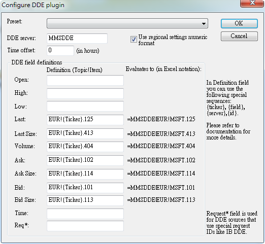

剛接觸AB,按照網路上的說明,我測試設定抓取歐元1分鐘報價,但遲遲都無法成功,不知道哪邊出錯了呢?
使用鉅富贏家,所以DDE Server設定 MMSDDELast設定為EUR!{Ticker}.125    <-- (1)請問這是指收盤價嗎? 另外上面開高低收不用設定?
Last Size設定為 EUR!{Ticker}.413  <-- (2)請問這個是指什麼呢?
Volume設定為 EUR!{Ticker}.404  <--(3)這代表是1分鐘的的成交量嗎?
最後設定完畢,我有去Symbol新增NZD,但遲遲都沒有動靜,可否詢問一下大家我哪邊有錯誤嗎? 謝謝

{Ticker}應要有項目.我沒用鉅富,但您可先用Excel設看看連不連的上,如Excel都連不上,那AB當然連不上.

感謝R大,我會再試試看

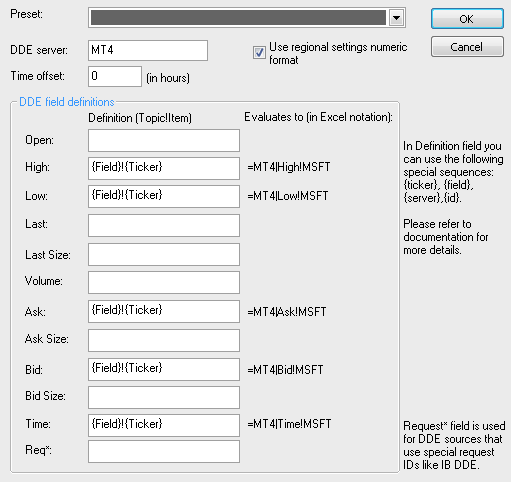

Have never heard of MMSDDE but this is how to set up the DDE plug-in to connect to Metatrader. And it works. But first you need to establish a symbol in the Symbol -> New. And since DDE doesn't provide any backfill you need to write a backfill script (jscript or vbscript) that imports data exported by a Metatrader export script.
