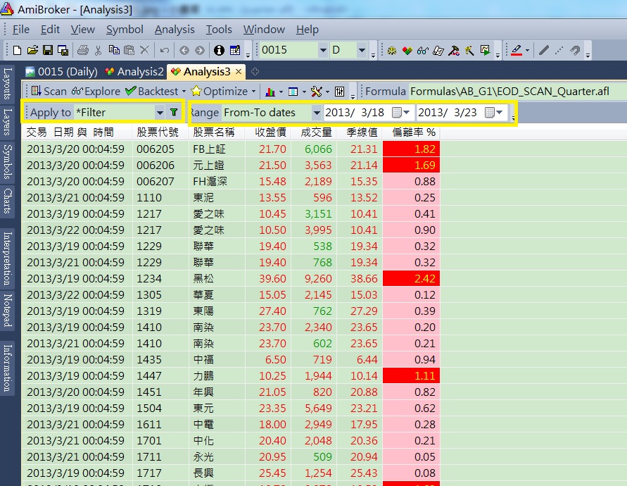

發表於 13-3-23 11:20 | 顯示全部樓層
本帖最後由 calvinhorng 於 13-3-23 11:26 編輯
  1. _SECTION_BEGIN("Custom Explorer");
  2. if (status("action")==actionExplore)
  3. {
  4.   SetOption("NoDefaultColumns", True );
  5.   val_Q=EMA(C,60);
  6.   dev_Q=(C-val_Q)/val_Q;
  7.   Filter=Cross(Close,EMA(C,60)) AND V>=500;
  8.   AddColumn(DateTime(), "交易  日期 與  時間   ", formatDateTime);
  9.   AddTextColumn(Name(), "股票代號");
  10.   AddTextColumn(FullName() , "股票名稱");
  11.   AddColumn(C, "收盤價", 1.2, IIf(C > Ref(C,-1), colorRed, colorGreen),-1);
  12.   AddColumn(V, "成交量", 1, IIf(V > Ref(V,-1), colorRed, colorGreen),-1);
  13.   AddColumn(val_Q, "季線值", 1.2, IIf(val_Q > Ref(val_Q,-1), colorRed, colorGreen),-1);
  14.   AddColumn(dev_Q*100, "偏離率 %", 1.2,IIf(dev_Q>0.01,colorYellow, colorBlack), IIf(dev_Q>0.01,colorRed, colorPink),-1);
  15. }
  16. _SECTION_END();
複製代碼
建議參考 http://www.wisestocktrader.com/indicators/363-eod-trade-explorer
