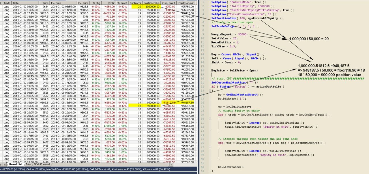

Hi,
The reason I use equity() in anaylsis is to see how position sizing/reinvestment works,
because equity() gives the equity result from backtest.
In real trading, I use IB Controller's function -- GetAccountValue() to get the total cash value.
For example, if I want to do fixed-dollar amout,
I just set my position size like...
Margindeposit=4000;
fixdollar=margindeposit*10;
ibc = GetTradingInterface("IB");
cash = ibc.GetAccountValue("TotalCashBalance");
SetPositionSize( cash/fixdollar, spsShares);
My purpose is to increase the position size by every 10 times of margin deposit for each share.
(the position size depends on my accout balance)
I wonder if equity() in analysis is wrong, then how can I do it right on both backtest and real trading.
thanks dude.

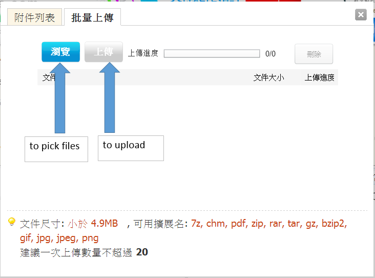

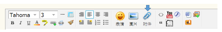

Hi,
You may upload your pics directly to the article by clikcing on "paper clip".

I have re-uploaded picture of last page again. I can read it. If you can't then you need new glasses. :-)

joshsmi, thank you very much!!!! i believe you are amibroker expert!
i reproduced your code in the pic u attached. i found that the shares still weird. so that i can confirm that, there must be my setting problem instead of coding.
after checking my setting, i found that in
setting->portfolio
limit trade size as % of entry bar volumn=10
this is the reason why my backtest didn't use all equity to invest. after setting it to zero (zero means no limit), the results is fine.
really appreciated for your help. i am new in amibroker and i am now accumulating my amibroker experience/knowledge.(your custom backtest interface eg equity at exit is also really helpful).
if lacking of your help and discussing here, i might not realize that the problem is in setting instead of coding.
Thank you very much joshsmi!

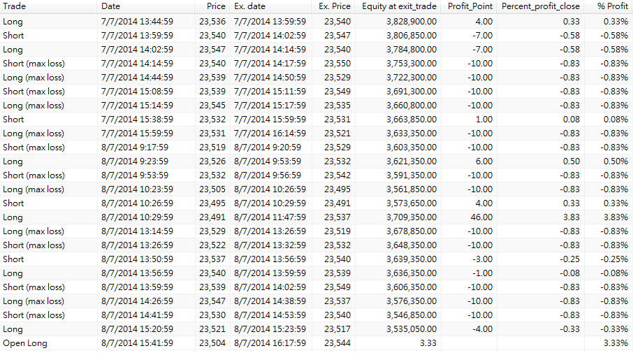

有一個關於iterate across open positions 的問題想請教一下:
// start CBT
SetCustomBacktestProc( "" );
if ( Status( "action" ) == actionPortfolio )
    bo = GetBacktesterObject(); //get access to backtester object
    bo.Backtest(1);        // run default backtest procedure
    eq = bo.EquityArray;
    st = bo.GetPerformanceStats(0); // get stats for all trades
   // Output Equity at entry column in backtest result list
    for ( trade = bo.GetFirstTrade(); trade; trade = bo.GetNextTrade() )
        EquityAtExit = Lookup( eq, trade.ExitDateTime );
        trade.AddCustomMetric( "Equity at exit_trade", EquityAtExit );
   // iterate through closed trades first
   for( trade = bo.GetFirstTrade(); trade; trade = bo.GetNextTrade() )
      // here we sum up profit per $100 invested
       //SumProfitPer100Inv = SumProfitPer100Inv + trade.GetPercentProfit();
       //NumTrades++;
                trade.AddCustomMetric("Percent_profit_close",trade.GetPercentProfit() );
   // iterate through eventually still open positions
   for( trade = bo.GetFirstOpenPos(); trade; trade = bo.GetNextOpenPos() )
       //NumTrades++;
trade.AddCustomMetric("Percent_profit_open",trade.GetPercentProfit() );
    bo.ListTrades();
附件是backtest result, 在最後兩段codes其實我預期result 會有兩個columns , 一個是 Percent_profit_close, 另一個是
Percent_profit_open
而Percent_profit_open 道理上全部都是零, 而最後一個row 才有數值(因為只有最後一行是open position)
但結果很奇怪, 不知道為什麼沒有Percent_profit_open的column, 而且Equity at exit_trade的最後一個row是3.33 , 一個很奇怪的數, 我估計這個值應該是Percent_profit_open吧?
應該是iterate 的logic 出了問題導致overlap了, 前輩可以提點一下嗎?
thanks.

It is strange because you are doing it wrong again
SetOption( "ExtraColumnsLocation", 12 );// defines location of CBT columns in AA
period = 20; // number of averaging periods
m = MA( Close, period ); // simple moving average
Buy = Cross( Close, m ); // buy when close crosses ABOVE moving average
Sell = Cross( m, Close ); // sell when closes crosses BELOW moving average
Short = Cover = 0;
BuyPrice = SellPrice = Close;
// start CBT
   bo.Backtest( 1 );      // run default backtest procedure
   eq = bo.EquityArray;// close equity
   //st = bo.GetPerformanceStats( 0 ); // get stats for all trades
   //NumTrades = 0;
   //SumProfitPer100Inv = 0;
      trade.AddCustomMetric( "Equity@Exit", EquityAtExit );
      percprofit = trade.GetPercentProfit();
      //SumProfitPer100Inv += percprofit;
      //NumTrades++;
      trade.AddCustomMetric( "%Profit", percprofit );
   for ( pos = bo.GetFirstOpenPos(); pos; pos = bo.GetNextOpenPos() )
      EquityAtExit = Lookup( eq, pos.ExitDateTime );
      pos.AddCustomMetric( "Equity@Exit", EquityAtExit );
      percprofit = pos.GetPercentProfit();
      //NumTrades++;
      pos.AddCustomMetric( "%Profit", percprofit );
   bo.ListTrades();
發表於 14-7-23 23:39 | 顯示全部樓層
本帖最後由 joshsmi 於 14-7-23 23:43 編輯
joshsmi 發表於 14-7-23 23:28
SetOption( "ExtraColumnsLocation", 12 );// def ...
Short = Cover = 0;
// start CBT
   //eq = bo.EquityArray;// close equity
   initialcap = st.GetValue( "InitialCapital" );
   //NumTrades = 0;
   SumProf = 0;
      SumProf += trade.GetProfit();// cum. profit
        EquityAtExit = initialcap + SumProf;
      //NumTrades++;
      SumProf += pos.GetProfit();// cum. profit
      //NumTrades++;

 樓主| 發表於 14-7-24 01:23 | 顯示全部樓層
thanks, but i also found a curious case. would you please try below:
Case 1:
just hide/not execute the first "for" loop, expected result is, there will be two columns "Equity@Exit" and "%Profit" created, with all zero value except the last row. indeed, this is the reasonable result as only the last row is open position.
Case2:
not execute "trade.AddCustomMetric( "%Profit", percprofit );" in the first for loop. the expected result is,
"Equity@Exit", filled whole column
"%Profit", only the last row have value
but, you will find that, the whole %profit column disappeared.
do you know why? i am quite concerned about this.
thanks!
發表於 14-7-24 02:25 | 顯示全部樓層
本帖最後由 joshsmi 於 14-7-24 02:30 編輯
You don't have any clue at all. Keep away from advanced programming and learn the basics first.
First of all if you comment/remove the whole first loop of my code then there will be no columns at all. If you comment/remove Addcustommetric there will be no column of that metric at all also.
Secondly it makes no sense to hide first loop. It is simply an idiotic thought to remove iteration through closed trades. You can not have just output of open trade. If you don't want any output then don't code any custom backtest metric at all. Instead do something else that does not have anything to do with programming like going to the beach.
